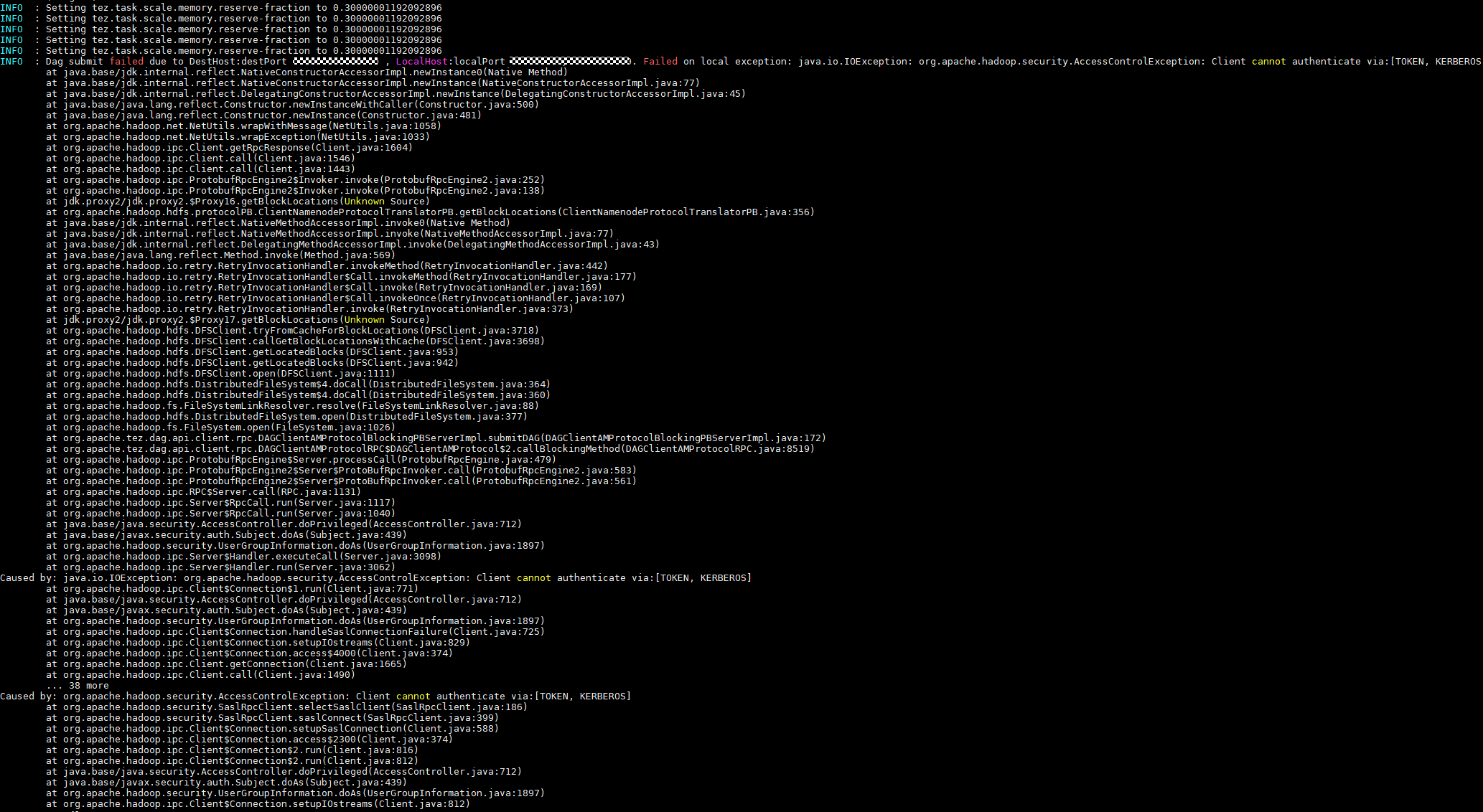

  1. When the Tez engine is used to execute Hive SQL tasks in MRS 3.5.1 or later, some queries fail and the following information is included in the displayed error message.
    Figure 1 Hive SQL task execution error

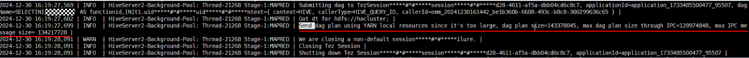

  2. Log in to the HiveServer node where the job is running and view the /var/log/Bigdata/hive/hiveserver/hive.log file. The file contains message Send dag plan using YARN local resources since it's too large, dag plan size=xxx, max dag plan size through IPC=xxx, max IPC message size=xxx, as shown in Figure 2.
    Figure 2 HiveServer log information
