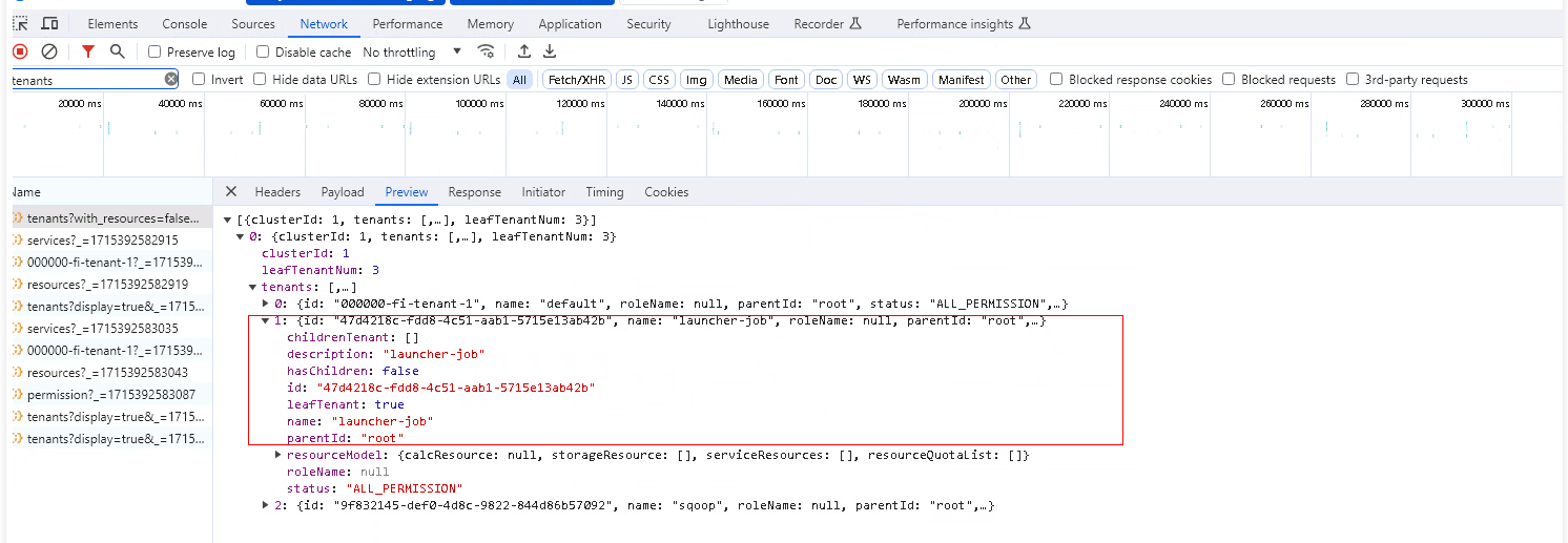

- Log in to the active management node as the omm user and run the following command to obtain the tenantID of the launcher-Job tenant:
curl -ki -L -u Username :Password "https://$(hostname -i):9022/mrsmanager/api/v2/clusters/1/tenants/resource_allocation/super_scheduler?resource_pool_name=default&parent_tenant_name=root&limit=10&offset=0&filter="

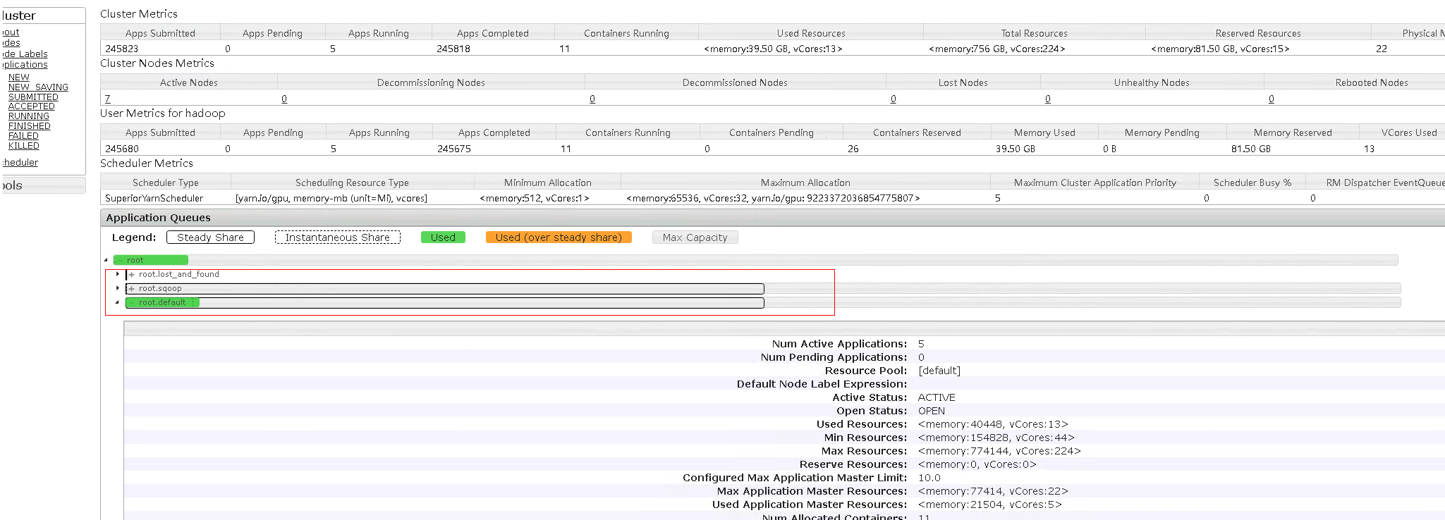

- Log in to FusionInsight Manager, choose Cluster > Services > JobGateway, click Instances, and perform a rolling restart on all JobServer instances.
- After the restart is complete, log in to the native YARN page and check whether the launcher-job queue is generated and whether the job can be submitted successfully.
