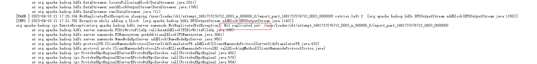

"NotReplicatedYet Exception: Not replicated yet" is occasionally reported when a large amount of data is written to HDFS.
Figure 1 Error message
