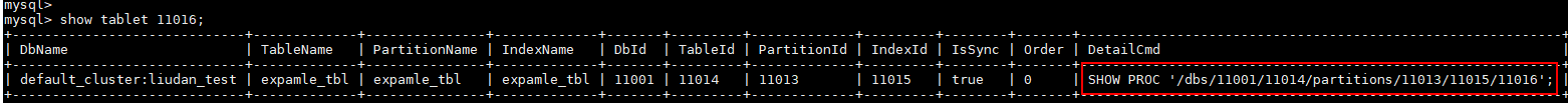

- Run the following command to obtain DetailCmd:
show tablet tabletId

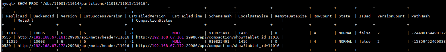

- Run DetailCmd. If the copies of the abnormal node have been removed, run the query again.
