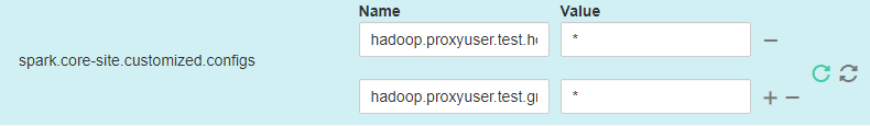

- Modify JDBCServer instance parameters. Log in to FusionInsight Manager and choose Cluster > Services > Spark. Click Configurations and then All Configurations, choose JDBCServer(Role) > Customization, find the spark.core-site.customized.configs parameter, and add the following custom parameters:
Parameter
Value
Description
hadoop.proxyuser.test.hosts
In the configuration, test is the actual user, which indicates that any proxy user can be used after user test is connected and the number of cluster nodes is not limited.
hadoop.proxyuser.test.groups

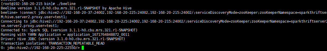

- Use Beeline commands of Spark to submit a task. Go to the Beeline directory of Spark.
cd Client installation directory/Spark/spark/binEnable the Beeline command.
./beeline
Submit a task as a proxy user.
!connect jdbc:hive2://IP address of the node where the ZooKeeper instance is deployed:ZooKeeper client port,IP address of the node where the ZooKeeper instance is deployed:ZooKeeper client port,IP address of the node where the ZooKeeper instance is deployed:ZooKeeper client port/;serviceDiscoveryMode=zooKeeper;zooKeeperNamespace=sparkthriftserver;saslQop=auth-conf;auth=KERBEROS;principal=spark2x/hadoop.hadoop.com@HADOOP.COM;hive.server2.proxy.user=test1
Specifically:
- IP address of the node where the ZooKeeper instance is: To obtain the IP address, on FusionInsight Manager, choose Cluster > Services > ZooKeeper and click Instance.
- Port number of the ZooKeeper client: To obtain the port number, on FusionInsight Manager, choose Cluster > Services > ZooKeeper, click Configurations and then All Configurations, and search for clientPort.
- hive.server2.proxy.user=test1: test1 is a proxy user.

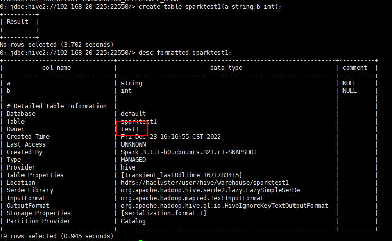

- Create a Spark table.
create table sparktest1(a string,b int);View the created table.
desc formatted sparktest1;
You can see that Owner of the table is the proxy user test1, and the proxy user is successfully used.

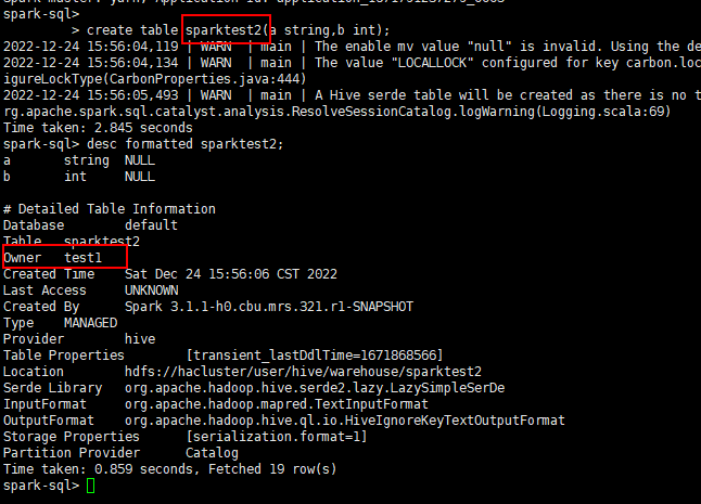

- Submit the spark-sql task.
spark-sql --master yarn --proxy-user test1 - Create a Spark table.
create table sparktest2(a string,b int);View the created table.
desc formatted sparktest2;

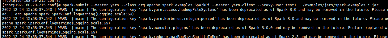

- Use the redelivered client to submit the spark-submit task.
spark-submit --master yarn --class org.apache.spark.examples.SparkPi --master yarn-client --proxy-user test1 Client installation directory/Spark/spark/examples/jars/spark-examples_*.jar
- View information about applications running in YARN.
You can see that the running user of the task is test1, and the proxy user is successfully used.
