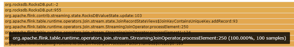

- On the ThreadDump of TaskManager, check whether the operator has been executed on the RocksDB operation interface for a long time. If the following information is displayed after multiple refreshes, the operator is executed on the RocksDB operation interface for a long time.
Join[5] -> Calc[6] -> Sink: print[7] (1/1)#0" Id=113 RUNNABLE (in native) at org.rocksdb.RocksDB.put(Native Method) at org.rocksdb.RocksDB.put(RocksDB.java:955) at org.apache.flink.contrib.streaming.state.RocksDBValueState.update(RocksDBValueState.java:103)
- Enable the flame graph (set rest.flamegraph.enabled to true) and submit the job again to view operator hotspots. Operator hotspots reach 100% in the figure below. Figure 1 Viewing operator hotspots in a flame graph
