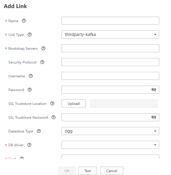

- Configure the thirdparty-kafka (ogg) link on the CDL web UI and add the Oracle link information.
- After the configuration is complete, create a job for capturing data from OGG to Hudi on the CDL web UI and start the job to receive heartbeat data.

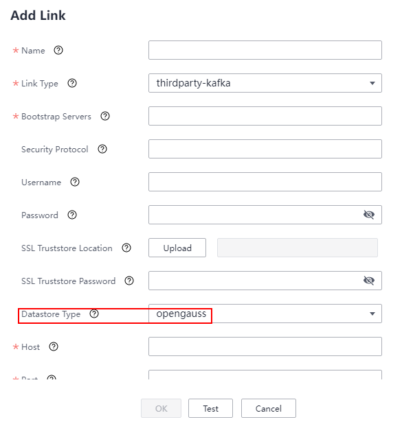

- On the CDL web UI, add the openGauss link information when configuring the thirdparty-kafka link of openGauss. If one primary openGauss node and multiple standby openGauss nodes are deployed, enter all IP addresses in Host.
- After the configuration is complete, create a job for capturing data from thirdparty-kafka to Hudi on the CDL web UI and start the job to receive heartbeat data.
