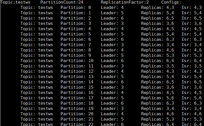

- Run the following command to view the topic details of the partition to be migrated:
Security mode:
./kafka-topics.sh --describe --bootstrap-server IP address of the Kafkacluster:21007 --command-config ../config/client.properties --topic topic name
Normal mode:
./kafka-topics.sh --describe --bootstrap-server IP address of the Kafka cluster:21005 --command-config ../config/client.properties --topic Topic name

- Obtain the partition distribution and node information from the command output in 6 and 7, and create the JSON file for reallocation in the current directory. To migrate data in the partition whose Broker_ID is 6 to the /srv/BigData/hadoop/data1/kafka-logs directory, the required JSON configuration file is as follows:
{"partitions":[{"topic": "testws","partition": 2,"replicas": [6,5],"log_dirs": ["/srv/BigData/hadoop/data1/kafka-logs","any"]}],"version":1}
- topic indicates the topic name, for example, testws.
- partition indicates the topic partition.
- The number in replicas corresponds to Broker_ID.
- log_dirs indicates the path of the disk to be migrated. In this example, log_dirs of the node whose Broker_ID is 5 is set to any, and that of the node whose Broker_ID is 6 is set to /srv/BigData/hadoop/data1/kafka-logs. Note that the path must correspond to the node.
