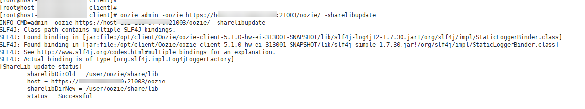

- If error information such as "classnotfoundException" is displayed, check whether the JAR package of the faulty class exists in the /user/oozie/share/lib directory of each component. If no, add the JAR package and go to Why Update of the share lib Directory of Oozie on HDFS Does Not Take Effect?. If the faulty class still cannot be found after the share lib directory is updated, check whether sharelibDirNew is /user/oozie/share/lib in the output of the command for updating the directory.
