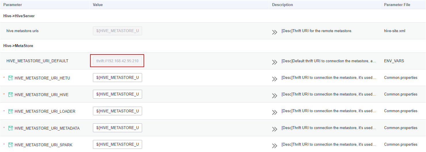

- Log in to FusionInsight Manager and choose Cluster > Services > Hive. On the displayed page, click the Configurations tab and then All Configurations, and search for the HIVE_METASTORE_URI parameter.
- Set the value of HIVE_METASTORE_URI_DEFAULT to the URI connection string of all Metastore instances.Figure 1 Default URI configuration for connecting to MetaStore

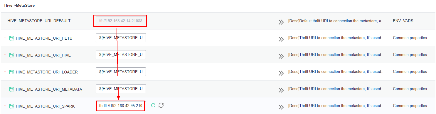

- Connect a component to a specified Metastore instance. Copy the value in 2, modify the configuration items based on the component name, save the modification, and restart the component.The following example shows how Spark2x connects to only two Metastore instances of Hive.
- Copy the default configuration of HIVE_METASTORE_URI_DEFAULT to the URI configuration item HIVE_METASTORE_URI_SPARK of Spark2x. If Spark2x needs to connect to only two Metastore instances, retain two nodes as required. Click Save.
- Choose Cluster > Services > Spark2x. On the displayed page, click the Instance tab, select the instances whose configuration has expired, and choose More > Restart Instance. In the dialog box that is displayed, enter the password and click OK to restart the instances.
