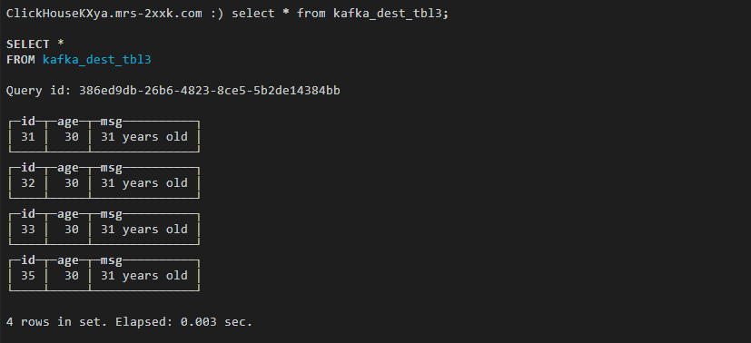

The result is as follows:>{"id":31, "age":30, "msg":"31 years old"} >{"id":32, "age":30, "msg":"31 years old"} >{"id":33, "age":30, "msg":"31 years old"} >{"id":35, "age":30, "msg":"31 years old"} - Use the ClickHouse client to log in to the ClickHouse instance node in 3 and query the ClickHouse table data, for example, to query the replicated table kafka_dest_tbl3. It shows that the data in the Kafka message has been synchronized to this table.
select * from kafka_dest_tbl3;
