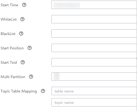

- Click the plus sign (+) to display more parameters.
- WhiteList: Enter the name of the table in the database, for example, myclass.
- Topic Table Mapping: In the first text box, enter a topic name (the value must be different from that of Name in 4), for example, myclass_topic. In the second text box, enter a table name, for example, myclass. The value must be in one-to-one relationship with the topic name entered in the first text box.)
- Click OK. The PgSQL job parameters are configured.

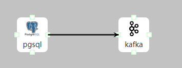

- Configure Kafka job parameters.
- On the Job Management page, drag the kafka icon on the left to the editing area on the right and double-click the icon to go to the Kafka job configuration page. Configure parameters based on Table 4.
- Click OK.
- After the job parameters are configured, drag the two icons to associate the job parameters and click Save. The job configuration is complete.
