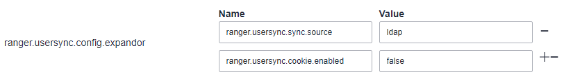

- Log in to FusionInsight Manager by referring to Accessing FusionInsight Manager, choose Cluster > Services > Ranger, click Configurations, and click All Configurations. Click UserSync(Role) and click Customization.
- In the ranger.usersync.config.expandor area, set ranger.usersync.sync.source to ldap and ranger.usersync.cookie.enabled to false, as shown in the following figure.

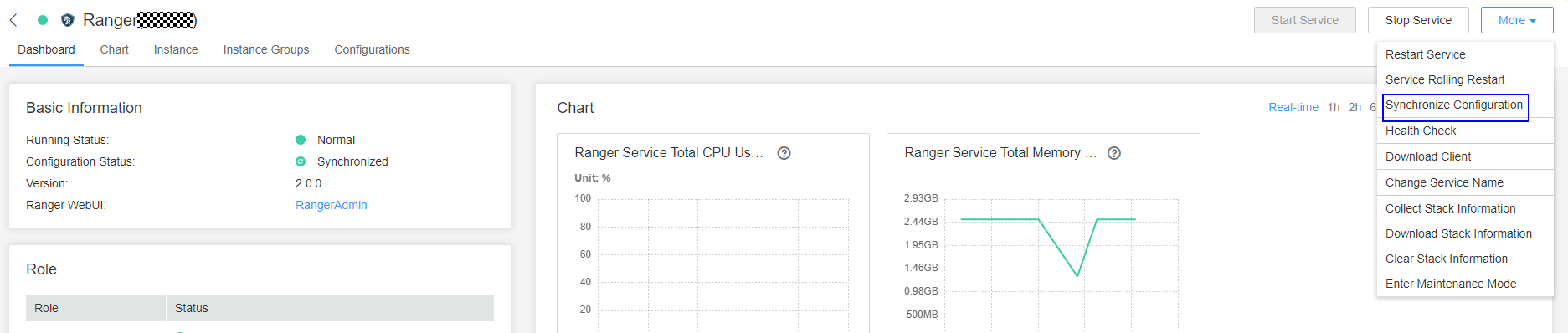

- In the upper right corner of the Ranger Dashboard page, click More and choose Synchronize Configuration.

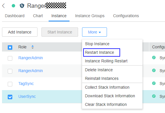

- On the Ranger instance page, select the UserSync instance and choose More > Restart Instance.
