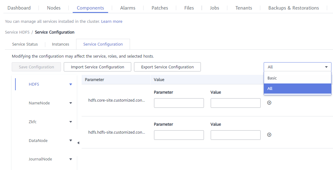

The Basic Configuration tab page is displayed by default. To modify more parameters, click the All Configurations tab. The navigation tree displays all configuration parameters of the service. The level-1 nodes in the navigation tree are service names or role names. The parameter category is displayed after the level-1 node is expanded. (The following figure uses the HDFS component as an example.)
 - In the navigation tree, select the specified parameter category and change the parameter values on the right.

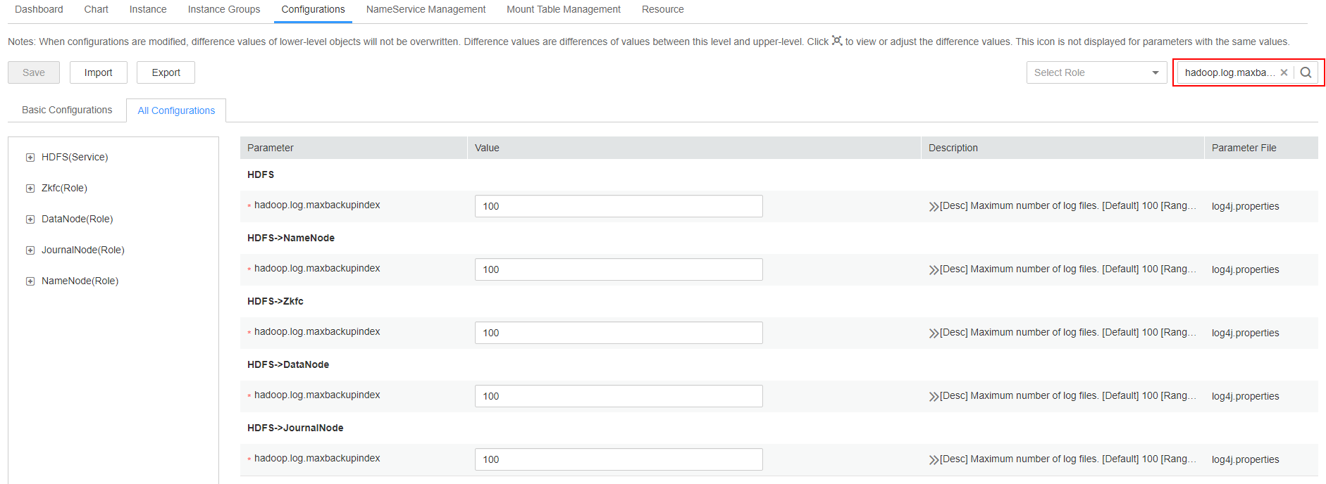

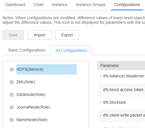

If you are not sure about the location of a parameter, you can enter the parameter name in search box in the upper right corner. The system searches for the parameter in real time and displays the result. (The following figure uses the HDFS component as an example.)
