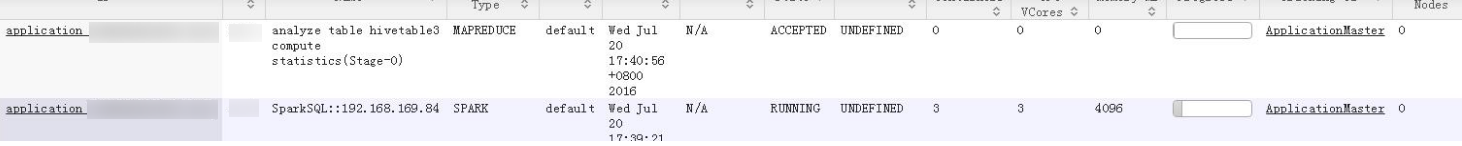

When the statement is executed, the SQL statement starts the analyze table hivetable2 compute statistics MapReduce tasks. On the ResourceManager Web UI of Yarn, the task is not executed due to insufficient resources. As a result, the task is suspended.
Figure 1 ResourceManager web UI
