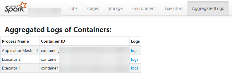

Spark supports this function. As shown in Figure 1, the AggregatedLogs tab is added to the HistoryServer page. You can click logs to view aggregated logs.
