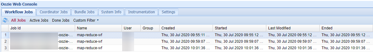

- Choose Cluster > Name of the desired cluster > Services > Oozie, click the hyperlink next to Oozie WebUI to go to the Oozie page, and view the task execution result on the Oozie web UI. Figure 1 Task execution result
