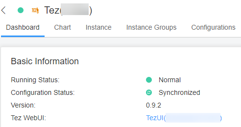

- If the execution engine is Tez, log in to FusionInsight Manager, choose Cluster > Services > Tez, and click the hyperlink on the right of Tez Web UI to access the Tez web UI.

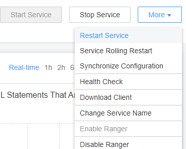

- Choose Dashboard. On the displayed page, choose More > Restart Service, enter the password of the current user, and click OK to restart the Hive service.

- If the execution engine is Spark, log in to FusionInsight Manager, choose Cluster > Services > Spark, and click the hyperlink on the right of Spark Web UI to access the Spark web UI.
