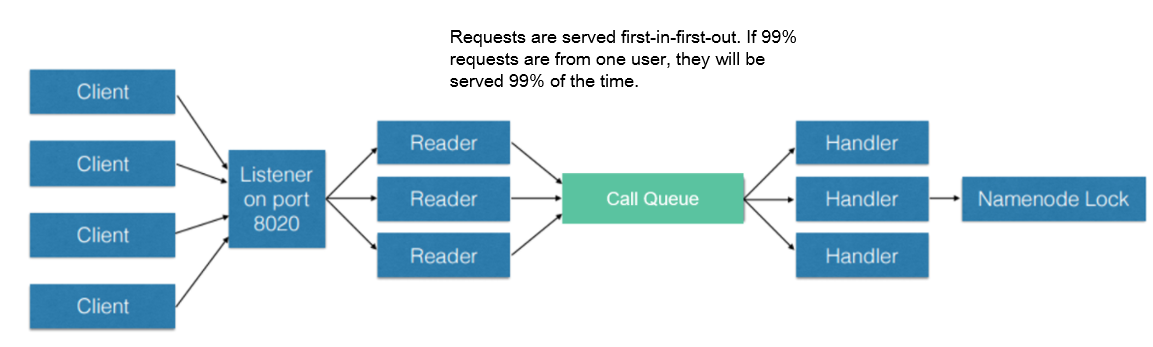

When NameNodes are overloaded and fail to respond, the Hadoop clusters may be blocked. This is caused by the initial design of Hadoop. In Hadoop, the NameNode functions as an independent device and coordinates various HDFS operations in its namespace. These operations include obtaining data block locations, listing directories, and creating files. The NameNode receives HDFS operations, regards them as RPC calls, and places them in the FIFO call queue for read threads to process. Requests in FIFO call queue are served first-in first-out. However, users who perform more I/O operations are served more time than those performing fewer I/O operations. In this case, the FIFO is unfair and causes the delay.

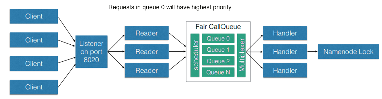

The unfair problem and delaying mentioned before can be improved by replacing the FIFO queue with a new type of queue called FairCallQueue. In this way, FAIR queues assign incoming RPC calls to multiple queues based on the scale of the caller's call. The scheduling module tracks the latest calls and assigns a higher priority to users with a smaller number of calls.
Notes and Constraints
This section applies to MRS 3.x or later.
Procedure
- FairCallQueue ensures quality of service (QoS) by internally adjusting the order in which RPCs are invoked. This queue consists of the following parts:
- DecayRpcScheduler: used to provide priority values from 0 to N (the value 0 indicates the highest priority).
- Multi-level queues (located in the FairCallQueue): used to ensure that queues are invoked in order of priority.
- Multi-channel converters (provided with Weighted Round Robin Multiplexer): used to provide logic control for queue selection.
After the FairCallQueue is configured, the control module determines the sub-queue to which the received invoking is allocated. The current scheduling module is DecayRpcScheduler. This module continuously tracks the priority numbers of various invoking requests and periodically decreases the numbers.
