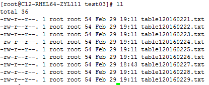

  1. In the directory /opt/houjt/test03 on the SFTP server, create multiple files with table1 as the prefix, .txt as the suffix, and yyyyMMdd as the date format in the middle of the file name.
    Figure 1 Example
