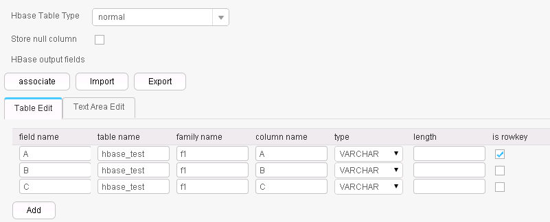

Configure the HBase Output operator, as shown in the following figure.

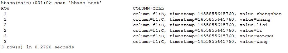

After the job execution is complete, view the data in the hbase_test table.
