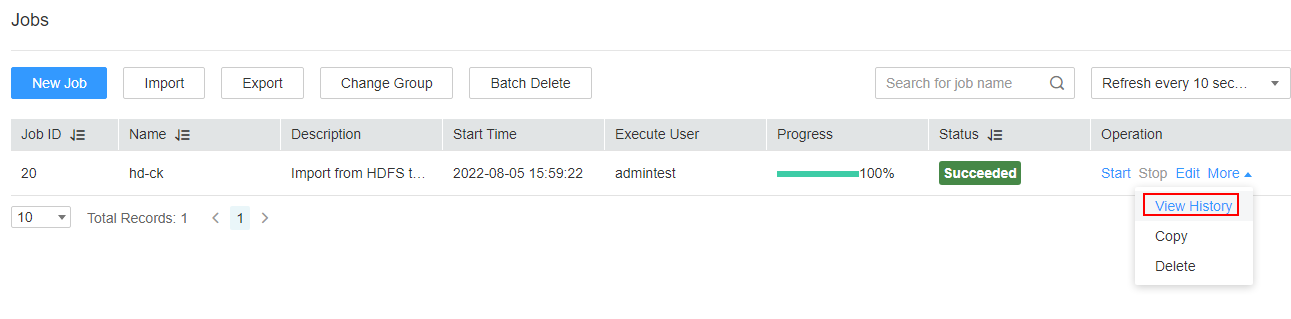

- Query historical records of a Loader job.
- Locate the row that contains the job to be viewed.
- Click More and select View History to view the job execution history. Figure 2 Viewing historical records
