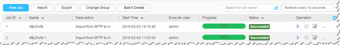

  3. Access the Loader web UI.
    1. Log in to FusionInsight Manager. For details, see Accessing FusionInsight Manager.
    2. Choose Cluster > Services > Loader.
    3. Click LoaderServer(Node name, Active). The Loader web UI is displayed.
      Figure 1 Loader web UI
  4. Create a Loader data export job. Click New Job. Select the required job type in 1. Basic Information and click Next.

  8. On the Loader WebUI page, you can view, start, stop, copy, delete, edit, and view historical information about created jobs.
    Figure 2 Viewing Loader Jobs
