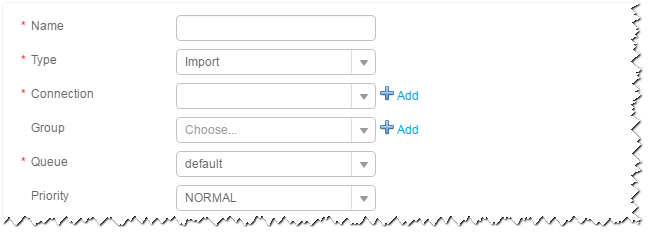

- Click New Job to go to the Basic Information page and set basic job information. Figure 2 Basic Information
- Set Name to the name of the job.
- Set Type to Import.
- Set Group to the group to which the job belongs. No group is created by default. You need to click Add to create a group and click OK to save the created group.
- Set Queue to the Yarn queue that executes the job. The default value is root.default.
- Set Priority to the priority of the Yarn queue that executes the job. The default value is NORMAL. The options are VERY_LOW, LOW, NORMAL, HIGH, and VERY_HIGH.
- In the Connection area, click Add to create a connection, set Connector to sftp-connector, click Add, set connection parameters, and click Test to verify whether the connection is available. When "Test Success" is displayed, click OK. Loader allows multiple SFTP servers to be configured. Click Add to add the configuration information of multiple SFTP servers.
