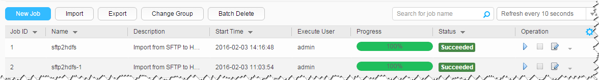

- Click LoaderServer(Node name, Active). The Loader web UI is displayed. Figure 1 Loader web UI
- Create a Loader data import job. Click New Job. Select the required job type in 1. Basic Information, and click Next.

- On the Loader web UI, view, start, stop, copy, delete, edit, or view historical information about created jobs. Figure 2 Viewing Loader jobs
