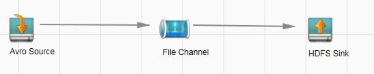

- Set Agent Name to server. Select and drag the source, channel, and sink to be used to the GUI on the right, and connect them.
For example, use Avro Source, File Channel, and HDFS Sink, as shown in Figure 4.
- Double-click the source, channel, and sink. Set corresponding configuration parameters by referring to Table 2 based on the actual environment.

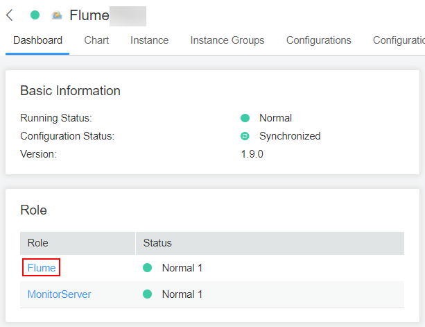

- Log in to FusionInsight Manager and choose Cluster > Services > Flume. In the Instances tab, click the Flume role whose configuration file is to be uploaded. Figure 5 Clicking the Flume role

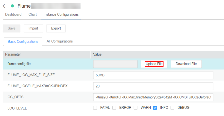

- On the Instance Configurations page, click Upload File next to flume.config.file and select the properties.properties file. Figure 6 Uploading a file
- An independent server configuration file can be uploaded to each Flume instance.
- This step is required for updating the configuration file. Modifying the configuration file on the background is an improper operation because the modification will be overwritten after configuration synchronization.
- Click Save, and then click OK.
