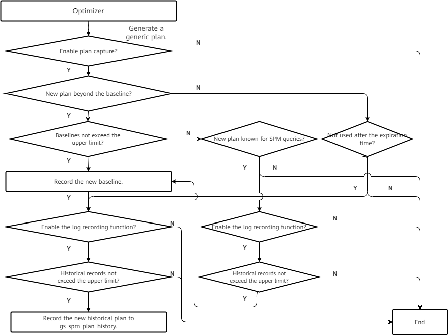

This feature involves two parts: fast detection and fast recovery of plan changes. The following briefly describes these two parts:
- Fast detection
To implement full plan change history, the most direct method is to record the difference between each execution plan and the last execution plan. This method causes a large performance overhead. Therefore, this feature records change events in the following scenarios to ensure performance and resource usage:
- The optimizer generates a new plan that does not exist in the SPM baseline.
- The optimizer generates an old plan that exists in the SPM baseline but has not been executed for a period of time.
Figure 1 shows the execution process.
To use this feature, ensure that the GUC parameter spm_enable_plan_capture is set to STORE and the change history recording function spm_enable_plan_history_logging is enabled.
According to Figure 1, the change events caused by new plans are recorded except in the following cases:
- Scenario 1: If the number of captured baselines exceeds the upper limit (spm_plan_capture_max_plannum), check whether the current plan is a new plan captured by the SPM. If spm_enable_plan_history_logging is enabled and the number of historical records does not exceed the upper limit, extra baseline capture is performed and historical records are recorded.
- Scenario 2: If the number of currently recorded change events exceeds the upper limit (spm_plan_capture_max_plannum), historical records are not generated.
To ensure that more historical records can be recorded during long-term running, the SPM sets a scheduled task to clear historical records every 24 hours after the database is started. The SPM checks the percentage of the current historical records to the maximum number. If the percentage exceeds the threshold, the SPM deletes historical records, the oldest historical records are deleted to ensure that the number of records is less than the percentage specified by spm_plan_history_reserved_percentage.
