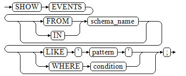

Syntax
SHOW EVENTS [{FROM | IN} schema_name] [LIKE 'pattern' | WHERE condition];
