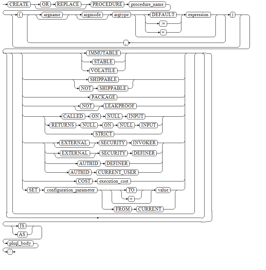

Syntax
CREATE [ OR REPLACE ] PROCEDURE procedure_name
    [ ( {[ argname ] [ argmode ] argtype [ { DEFAULT | := | = } expression ]}[,...]) ]
       { IMMUTABLE | STABLE | VOLATILE }
       | { SHIPPABLE | NOT SHIPPABLE }
       | {PACKAGE}
       | [ NOT ] LEAKPROOF
       | { CALLED ON NULL INPUT | RETURNS NULL ON NULL INPUT | STRICT }
       | {[ EXTERNAL ] SECURITY INVOKER | [ EXTERNAL ] SECURITY DEFINER | AUTHID DEFINER | AUTHID CURRENT_USER}
       | COST execution_cost
       | SET configuration_parameter { [ TO | = ] value | FROM CURRENT }
 { IS | AS }
plsql_body
