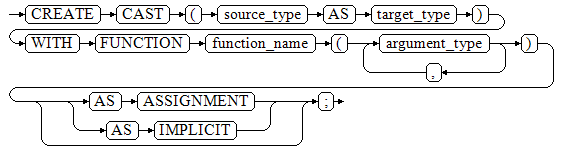

  • Define the CAST as a conversion with function.
    CREATE CAST (source_type AS target_type)
        WITH FUNCTION function_name (argument_type [, ...])
        [ AS ASSIGNMENT | AS IMPLICIT ];

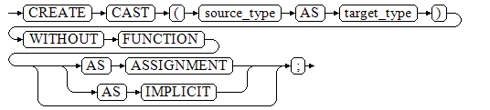

  • Define the CAST as a conversion without function.
        WITHOUT FUNCTION

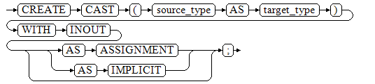

  • Defines the CAST as a conversion with I/O.
        WITH INOUT
