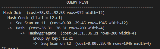

Normal query execution:
1 | explain select * from t1 where t1.c1 in (select t2.c1 from t2); |
Plan
