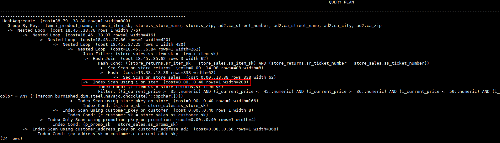

To specify an index-based hint for a scan, create an index named i on the i_item_sk column of the item table.
create index i on item(i_item_sk);
Hint the query plan in Examples as follows:
2
3
4
5
explain
select /*+ indexscan(item i) */ i_product_name product_name ...
or
EXPLAIN
SELECT /*+ index(item i) */ i_product_name product_name ...
item is scanned based on an index. The optimized plan is as follows.
