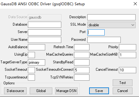

On the User DSN tab page, click Add and choose GaussDB Unicode for setup.
For details about the parameters, see Configuring a Data Source in the Linux OS.

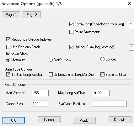

You can click Datasource to configure whether to print logs.

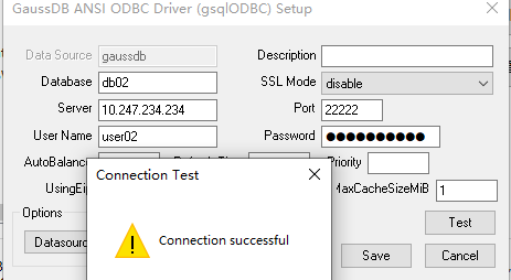

- Test the connection.
Click Test.
- If the following information is displayed, the configuration is correct and the connection succeeds.
- If error information is displayed, the configuration is incorrect. Check whether the preceding configurations are correct.
