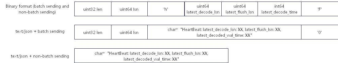

  10. Heartbeat log output option
    enable-heartbeat: specifies whether to generate heartbeat logs. The default value is false.
    If the heartbeat log output option is enabled, heartbeat logs will be generated. The heartbeat logs can be in the binary or TEXT/JSON format. For a binary heartbeat log message, it starts with a character 'h' and then the heartbeat log content: an 8-byte uint64 LSN indicating the end position of WAL reading when the heartbeat logical log is sent, an 8-byte uint64 LSN indicating the location of the WAL that has been flushed to disk when the heartbeat logical log is sent, and an 8-byte int64 timestamp (starting from January 1, 1970) indicating the timestamp when the latest decoded transaction log or checkpoint log is generated; then, it ends with character 'F'. TEXT/JSON heartbeat log messages that are sent in batches end with '0'. There is no such terminator for each TEXT/JSON heartbeat log message. The message content is transmitted in big-endian mode. The following figure shows the format.
