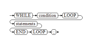

WHILE_LOOP Statements
Syntax diagram
Figure 2 while_loop::=
If the conditional expression is true, a series of statements in the WHILE statement are repeatedly executed and the condition is decided each time the loop body is executed.

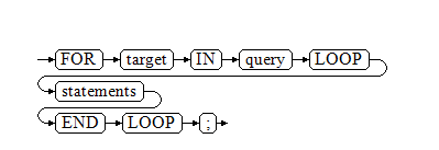

FOR_LOOP Query Statements
Syntax diagram
Figure 4 for_loop_query::=
  • The variable target is automatically defined, its type is the same as that in the query result, and it is valid only in this loop. The target value is the query result.
  • You can use EXECUTE to add a dynamic query and use USING to insert parameters to the query. For details, see the dynamic query content in Example.

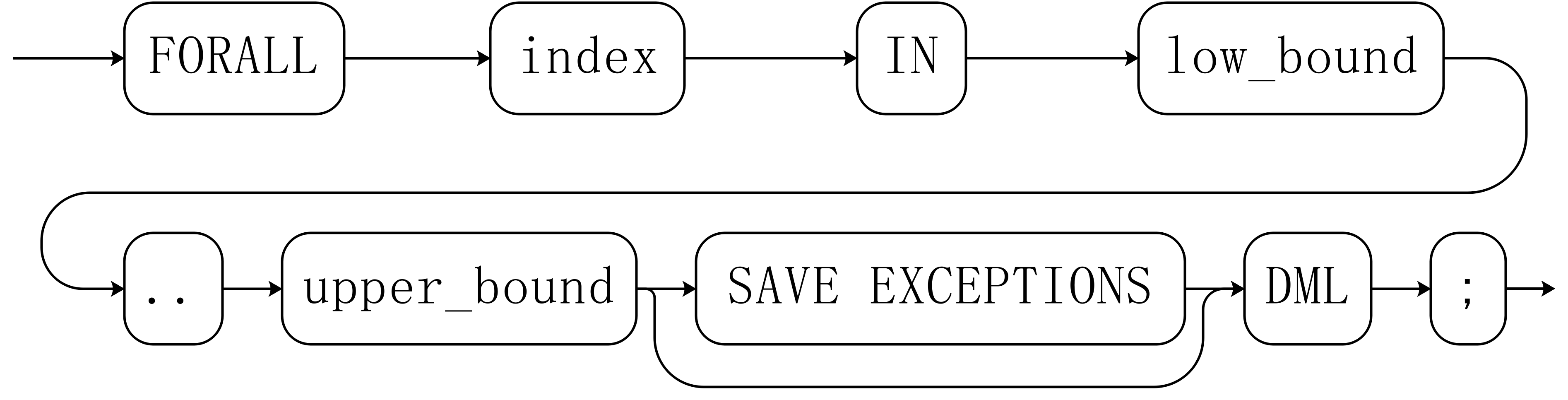

FORALL Batch Query Statements
Syntax diagram
Figure 5 forall::=
  • The variable index is automatically defined as the integer type and exists only in this loop. The value of index falls between the value of low_bound and the value of upper_bound.
  • If SAVE EXCEPTIONS is specified, exceptions occurred during DML execution in the loop body are saved in SQL&BULK_EXCEPTIONS and an exception is thrown after the execution is complete. If there is no abnormal execution result in the loop, the loop will not be rolled back in the current subtransaction.
