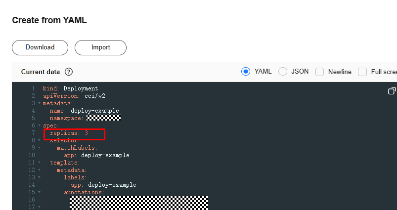

- You can set the number of pods when creating a workload.
- When creating a workload using YAML, you can directly set the number of pods. Figure 1 Setting the number of pods using YAML

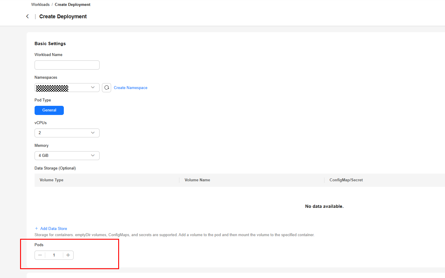

- When creating a workload on the console, you can specify the number of pods. Figure 2 Setting the number of pods on the console

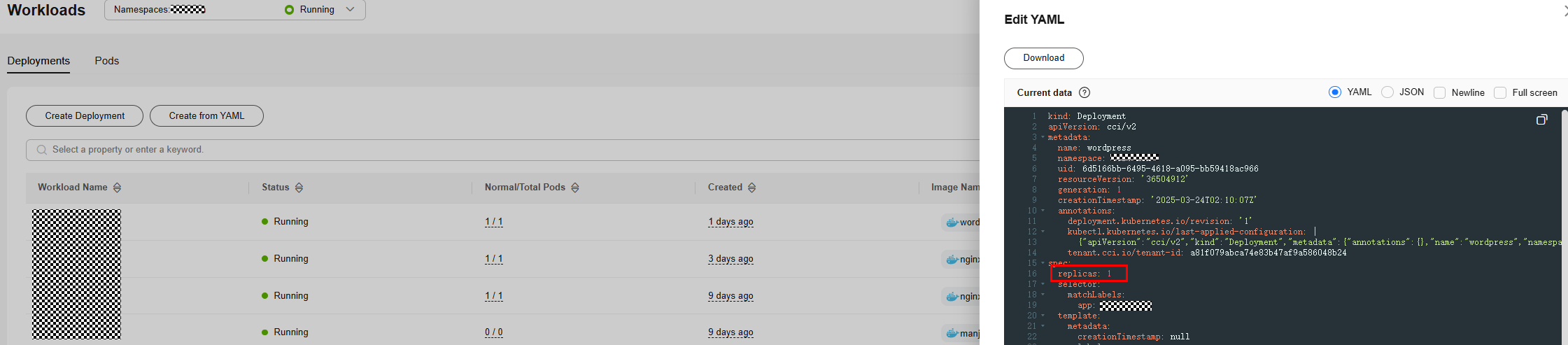

- After a workload is created, click Edit YAML and modify replicas. Figure 3 Modifying the number of pods in the YAML file
