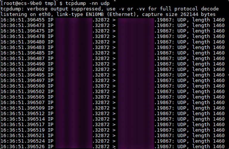

- Run the following command to capture packets and analyze UDP traffic attacks:
Figure 1 shows an example of the captured packets.

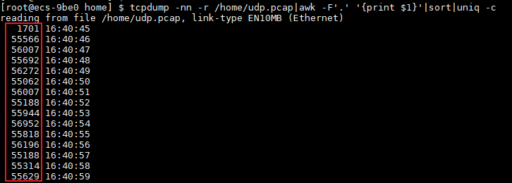

- Run the following command to analyze the captured packet information. Figure 2 shows the analysis result.

According to step 3, the checked device is sending dozens of 1460-byte UDP data packets to another IP address, which is far greater than the normal traffic. This indicates that the device is likely being used as an amplifier for UDP reflection attacks.
According to step b, the number of UDP connections per second is more than 50,000, indicating that the services provided by the device are used by attackers to launch UDP amplification attacks. So, necessary protection measures must be taken to prevent server resources from being exhausted by attack traffic.
