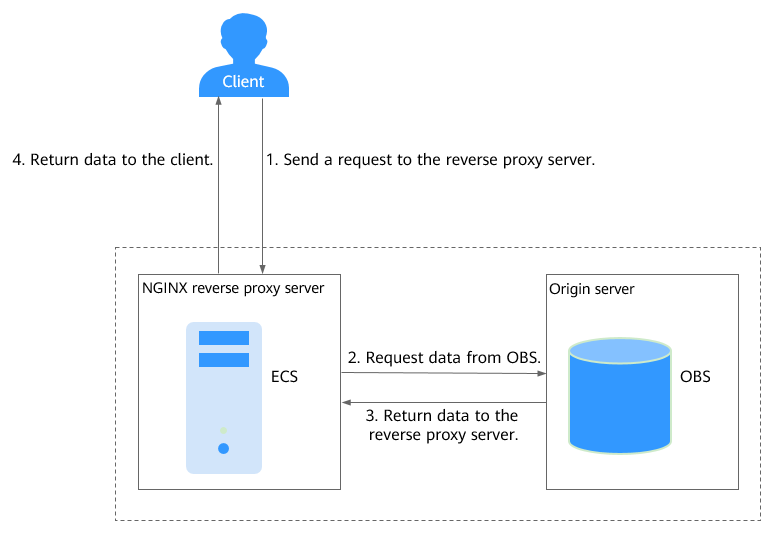

Solution Architecture
This part explains how to deploy NGINX on an ECS and set up an NGINX reverse proxy server. The proxy is imperceptible. Requests are sent to the reverse proxy server, which then obtains the required data from OBS and returns the data to users. The reverse proxy server and OBS work as a whole. Only the IP address of the proxy server is exposed, while the actual domain name or IP address of OBS is hidden.
Figure 1 Principles of accessing OBS through an NGINX reverse proxy

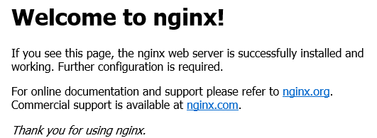

    6. Use a browser on any device to access http://ECS EIP. If the following information is displayed, NGINX is successfully installed.
      Figure 2 NGINX installed successfully

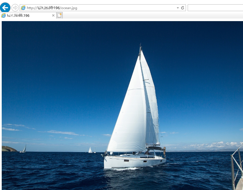

  4. Verify the reverse proxy configuration.
    On any device, use the ECS EIP and object name to access specified OBS resources. If the resources are properly accessed, the configuration is successful.
    For example, visit http://ECS EIP/ocean.jpg.
    Figure 3 Using a fixed IP address to access OBS resources
