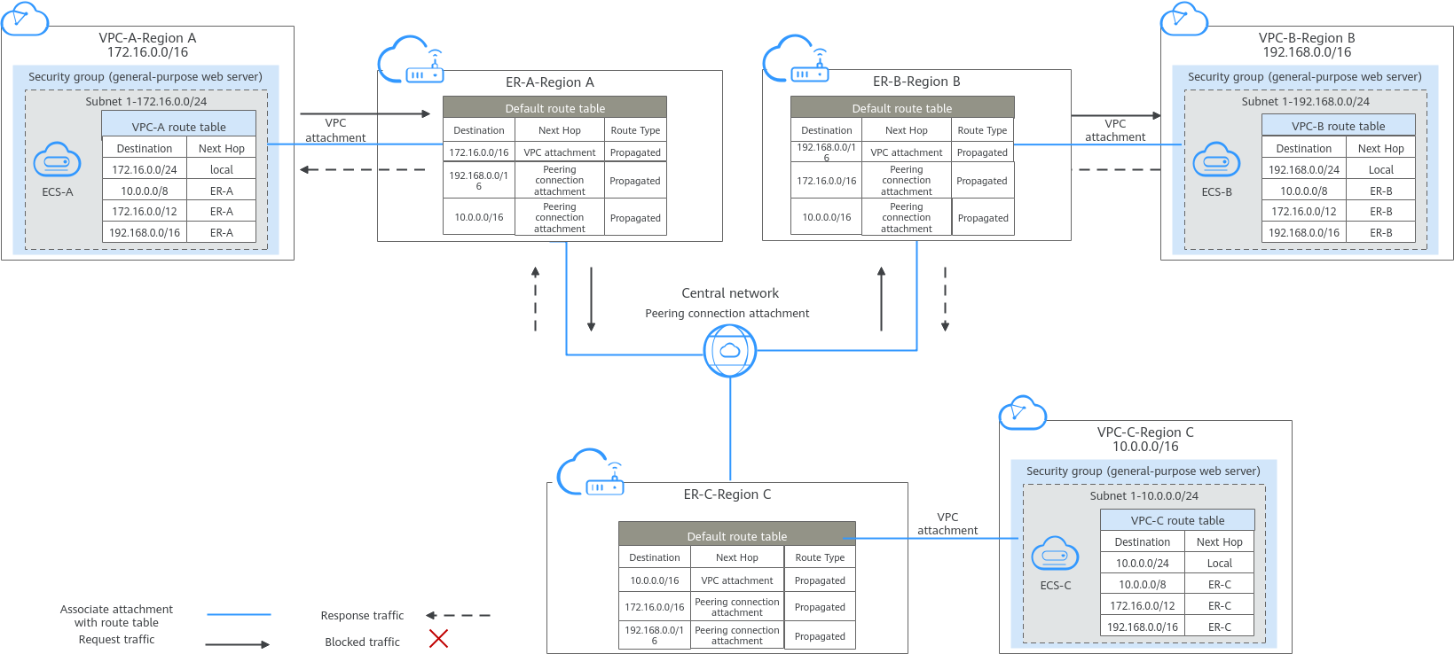

Figure 1 shows the network planning for communications among VPCs across regions.
In this example, one VPC is created and attached to an enterprise router in each region. Make the plan based on your service requirements.

| Enterprise routers | The network configuration for the enterprise router in the three regions is the same. Table 4 lists all routes required by the enterprise router. When a central network is set up to connect the enterprise routers, you must enable Default Route Table Association and Default Route Table Propagation for the enterprise routers. In this way, when an instance is added to an enterprise router, a route pointing to attachment will be automatically added for the enterprise router. |
| ECSs | An ECS is created in each VPC. If the ECSs are in different security groups, add rules to the security groups to allow access to each other. |
| Destination | Next Hop | Route Type |
| 10.0.0.0/8 | Enterprise Router | Static route (custom) |
| 172.16.0.0/12 | Enterprise Router | Static route (custom) |
| 192.168.0.0/16 | Enterprise Router | Static route (custom) |
- If you enable Auto Add Routes when creating a VPC attachment, you do not need to manually add static routes to the VPC route table. Instead, the system automatically adds routes (with this enterprise router as the next hop and 10.0.0.0/8, 172.16.0.0/12, and 192.168.0.0/16 as the destinations) to all route tables of the VPC.
- If an existing route in the VPC route tables has a destination to 10.0.0.0/8, 172.16.0.0/12, or 192.168.0.0/16, the routes will fail to be added. In this case, do not enable Auto Add Routes. After the attachment is created, manually add routes.
- Do not set the destination of a route (with an enterprise router as the next hop) to 0.0.0.0/0 in the VPC route table. If an ECS in the VPC has an EIP bound, the VPC route table will have a policy-based route with 0.0.0.0/0 as the destination, which has a higher priority than the route with the enterprise router as the next hop. In this case, traffic is forwarded to the EIP and cannot reach the enterprise router.
| Enterprise Router | Destination | Next Hop | Route Type |
| Region A: ER-A | VPC-A CIDR block: 172.16.0.0/16 | VPC attachment: er-attach-VPC-A | Propagated |
| VPC-B CIDR block: 192.168.0.0/16 | Peering connection attachment: region-A-region-B | Propagated | |
| VPC-C CIDR block: 10.0.0.0/16 | Peering connection attachment: region-A-region-C | Propagated | |
| Region B: ER-B | VPC-B CIDR block: 192.168.0.0/16 | VPC-B attachment: er-attach-VPC-B | Propagated |
| VPC-A CIDR block: 172.16.0.0/16 | Peering connection attachment: region-B-region-A | Propagated | |
| VPC-C CIDR block: 10.0.0.0/16 | Peering connection attachment: region-B-region-C | Propagated | |
| Region C: ER-C | VPC-C CIDR block: 10.0.0.0/16 | VPC-C attachment: er-attach-VPC-C | Propagated |
| VPC-A CIDR block: 172.16.0.0/16 | Peering connection attachment: region-C-region-A | Propagated | |
| VPC-B CIDR block: 192.168.0.0/16 | Peering connection attachment: region-C-region-B | Propagated |
