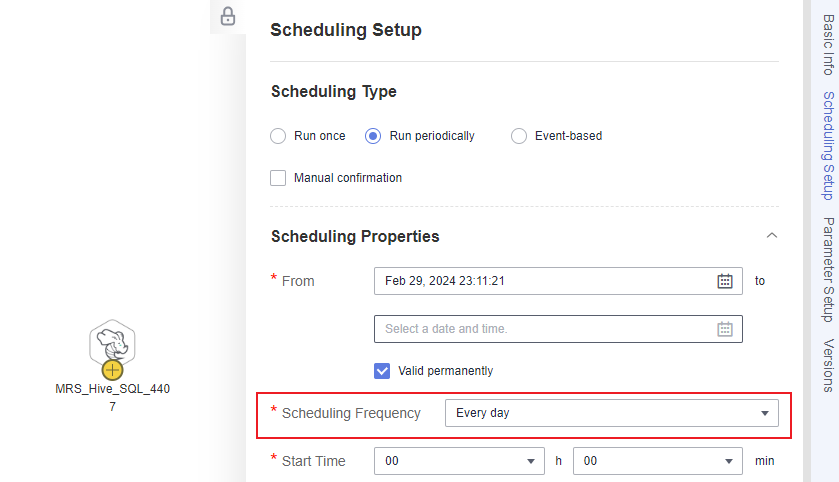

  1. In the left navigation pane of the DataArts Factory console, choose Data Development > Develop Job.
  2. Set Scheduling Frequency to Every day.
    Figure 1 Setting Scheduling Frequency to Every day

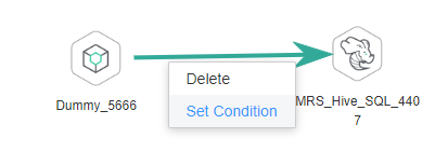

  3. Right-click the connection line between the Dummy node and its subsequent node and select Set Condition to configure a condition expression that is used to determine whether to execute the subsequent node.
    Figure 2 Configuring a condition expression

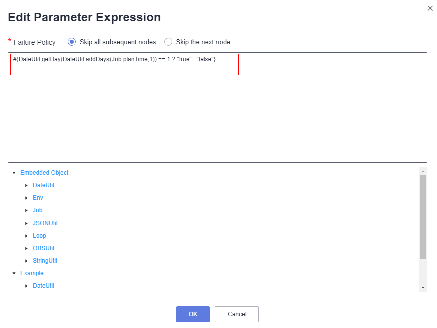

  4. Configure the expression as follows:
    #{DateUtil.getDay(DateUtil.addDays(Job.planTime,1)) == 1 ? "true" : "false"}
    The expression is used to obtain the current time and check whether the next day is 1st of a month. If yes, the current day is the last day of the current month, and the subsequent node will be executed; if no, the subsequent node will be skipped.
    Figure 3 Condition expression
    For example, if you want a job to be executed on the last day of each month, perform the above operations.
    For example, if you want a job to be executed on the seventh day of each month, perform the following operations:
    Configure the following expression to check whether the current day is 7th:
    #{DateUtil.getDay(Job.planTime) == 7 ? "true" : "false"}

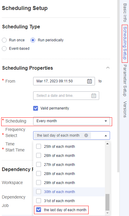

  1. In the left navigation pane of DataArts Factory, choose Development > Develop Job.
  2. Click Scheduling Setup on the right of the job canvas.
  3. Set Scheduling Type to Run periodically, Scheduling Frequency to Every month, and Select Time to the last day of each month.
    Figure 4 Setting the scheduling time to the last day of each month
    After the scheduling time is configured, the job will be automatically executed on the last day of each month.
