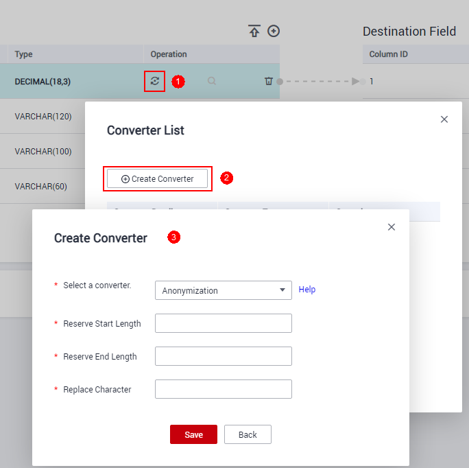

You can create a field converter on the Map Field page when creating a table/file migration job.
Figure 1 Creating a field converter

Anonymization
This converter is used to hide key information about the character string. For example, if you want to convert 12345678910 to 123****8910, configure the parameters as follows:
  • Set Reserve Start Length to 3.
  • Set Reserve End Length to 4.
  • Set Replace Character to *.
Figure 2 Anonymization

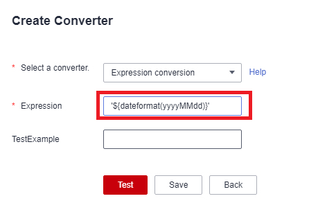

Expression Conversion
This converter uses the JSP expression language (EL) to convert the current field or a row of data. The JSP EL is used to create arithmetic and logical expressions. Within a JSP EL expression, you can use integers, floating point numbers, strings, the built-in constants true and false for boolean values, and null.

    71. Based on the specified offset type (month/day/hour/minute/second) and offset (positive number indicates increase and negative number indicates decrease), convert the time in the specified format to a new time, for example, add 8 hours to 2019-05-21 12:00:00.
      Expression: DateUtils.getCurrentTimeByZone("yyyy-MM-dd HH:mm:ss",value, "hour", 8)
