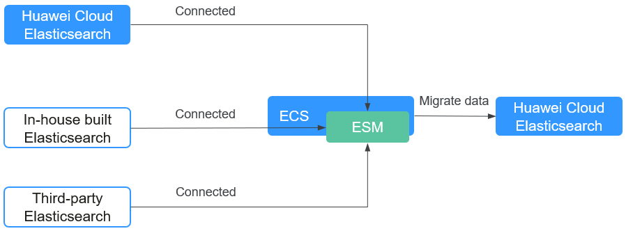

Figure 1 Migration procedure
Figure 1 shows how to migrate data between Elasticsearch clusters using ESM.
  1. Install ESM on a Linux VM.
  2. Run ESM commands to migrate indexes from the source cluster to the destination cluster.

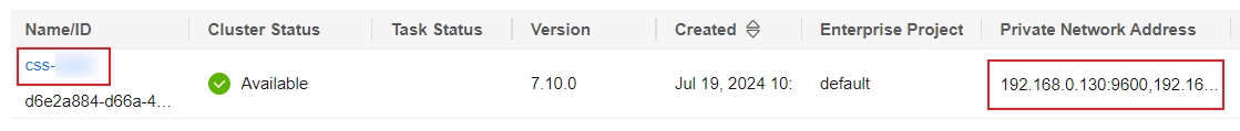

  1. Log in to the CSS management console.
  2. In the navigation pane on the left, choose Clusters > Elasticsearch.
  3. In the cluster list, find the destination cluster and obtain the cluster name and address.
