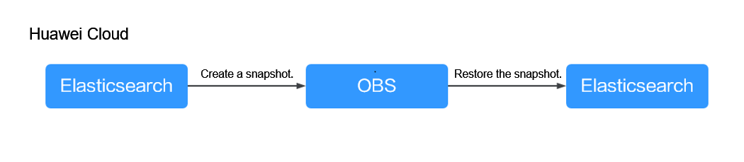

Solution Architecture
Figure 1 Migration procedure
Figure 1 shows the process of migrating data between Huawei Cloud Elasticsearch clusters using backup and restoration.
  1. Create a snapshot for the source Elasticsearch cluster and store the snapshot in an OBS bucket.
  2. Restore the snapshot to the destination Elasticsearch cluster.
