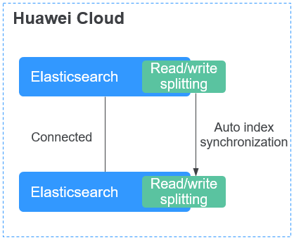

Figure 1 illustrates the general procedure for migrating data from one Huawei Cloud Elasticsearch cluster to another using the read/write splitting plugin of CSS.
- Use the read/write splitting plugin to set up a connection between the source (primary) and destination (secondary) clusters.
- Configure automatic index synchronization in the destination cluster to have data automatically synchronized from the source to the destination cluster. The synchronization interval is 30 seconds by default and can be changed.
- Check the status of auto synchronization to see if data migration has completed.

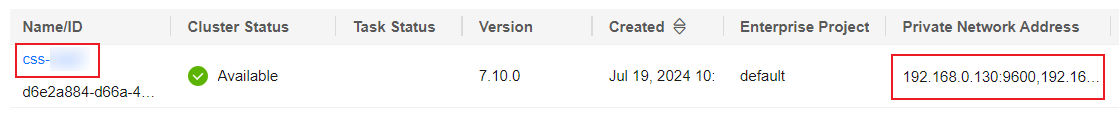

- In the cluster list, obtain the target cluster's private IP address from the Private IP Address column. Generally, the IP address format is <host>:<port> or <host>:<port>,<host>:<port>.
If the cluster has only one node, the IP address and port number of this single node are displayed, for example, 10.62.179.32:9200. If the cluster has multiple nodes and all of them are data nodes, the IP addresses and port numbers of all these nodes are displayed; if some of them are client nodes, only the IP addresses and port numbers of these client nodes are displayed; for example, 10.62.179.32:9200,10.62.179.33:9200.
