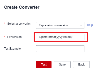

  • An expression processes the data of a field. When you create an expression converter, do not use a time macro. If you need to use a time macro, use either of the following methods (if the source is of the file type, only Method 1 is supported):
    • Method 1: When creating an expression converter, use two single quotation marks ('') to enclose the expression.
      For example, if expression ${dateformat(yyyy-MM-dd)} is not enclosed in quotation marks, the hyphen (-) in the value 2017-10-16 parsed from the expression will be recognized as a minus sign, and further calculation will be performed to generate result 1991, which is incorrect. If you enclose the expression in quotation marks, that is, '${dateformat(yyyy-MM-dd)}', you will obtain '2017-10-16', which is correct.
      Figure 2 Using two single quotation marks ('') to enclose an expression

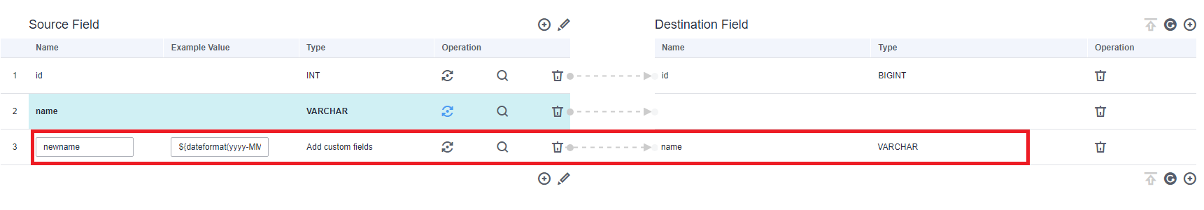

    • Method 2: Add a custom source field, enter a macro variable of date and time for Example Value, and map the field to a destination field again.
      Figure 3 Adding a custom source field
