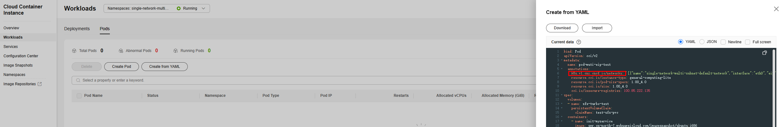

- Log in to the CCI 2.0 console.
- In the navigation pane, choose Workloads. On the Pods tab, click Create from YAML.
- Define the pod. The following is an example YAML file:
The k8s.v1.cni.cncf.io/networks field is used as an example. If the yangtse.io/multi-eip-ids field is required, see Table 1.
kind: Pod apiVersion: cci/v2 metadata: name: pod-muti-eip-test annotations: k8s.v1.cni.cncf.io/networks: '[{"name":"second-network","interface":"eth0"},{"name":"default-network","interface":"eth1"},{"name":"default-network","interface":"eth2"},{"name":"second-network","interface":"eth3"}]' resource.cci.io/instance-type: general-computing-lite resource.cci.io/pod-size-specs: 0.25_0.5 spec: containers: - name: init-myservice image: nginx:latest ports: - containerPort: 80 protocol: TCP resources: limits: cpu: 250m memory: 512Mi requests: cpu: 250m memory: 512Mi restartPolicy: Always terminationGracePeriodSeconds: 30 dnsPolicy: Default securityContext: {} imagePullSecrets: - name: imagepull-secretTable 1 yangtse.io/multi-eip-ids and k8s.v1.cni.cncf.io/networks description Field
