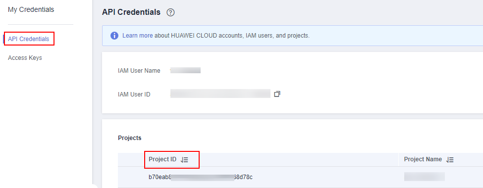

A project ID is required for some URLs when an API is called. You can obtain a project ID on the console.
The following procedure describes how to obtain a project ID:
- Sign up and log in to the management console.
- Click the username in the upper right corner and select My Credentials from the drop-down list.
- On the My Credentials page, view project IDs in the project list.Figure 1 Viewing project IDs
