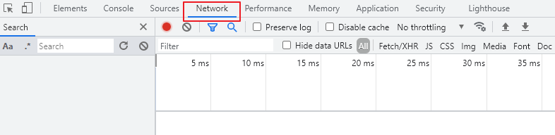

- Press F12 to open the developer debugging tool and click the Network tab. Figure 2 Network

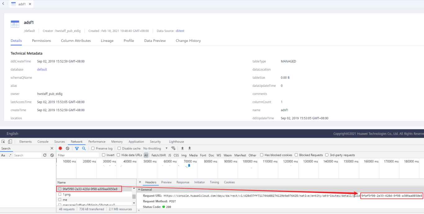

- In the network request, search for a long string whose name is similar to 09318f28-939f-4ab6-a374-9e621096652c. Figure 3 Searching for a long string
- Click the string and obtain the GUID from Request URL. Figure 4 Obtaining the GUID
